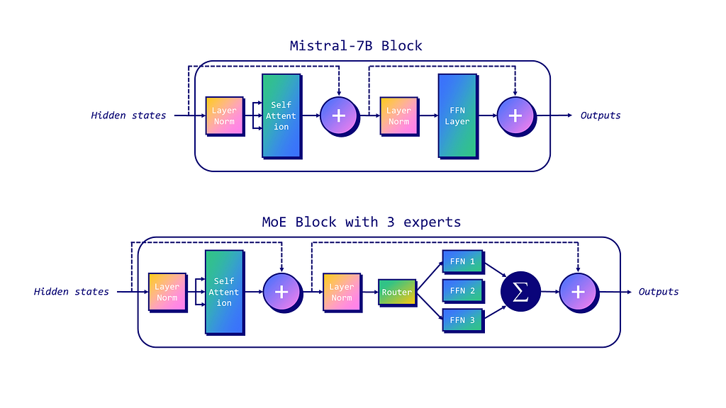

In the following example, we show how a Mistral-7B block is transformed into an MoE block with a sparse MoE layer (feedforward network 1, 2, and 3) and a router. This example represents an MoE with three experts, where two are currently engaged (FFN 1 and FFN 3).
Image by author
MoEs also come with their own set of challenges, especially in terms of fine-tuning and memory requirements. The fine-tuning process can be difficult due to the model’s complexity, with the need to balance expert usage during training to properly train the gating weights to select the most relevant ones. In terms of memory, even though only a fraction of the total parameters are used during inference, the entire model, including all experts, needs to be loaded into memory, which requires high VRAM capacity.
More specifically, there are two essential parameters when it comes to MoEs:
- Number of experts (num_local_experts): This determines the total number of experts in the architecture (e.g., 8 for Mixtral). The higher the number of experts, the higher the VRAM usage.
- Number of experts/token (num_experts_per_tok): This determines the number of experts that are engaged for each token and each layer (e.g., 2 for Mixtral). There is a tradeoff between a high number of experts per token for accuracy (but diminishing returns) vs. a low number for fast training and inference.
