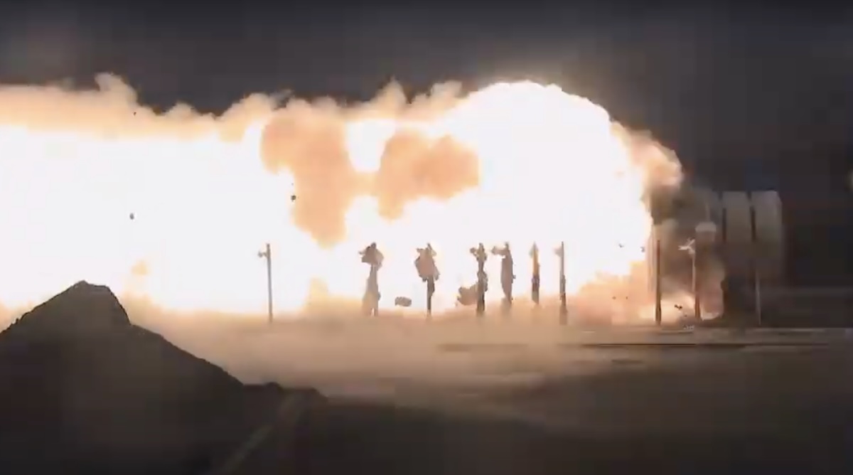

While the engine test in Mississippi apparently went according to plan, the ground firing of the new solid rocket booster didn't go quite as smoothly. Less than two minutes into the burn, the motor's exhaust nozzle violently shattered into countless shards of debris. You can watch the moment in the YouTube video below.

Unlike the RS-25 firing at Stennis, NASA chose to broadcast the booster test. Everything appeared to go well until 1 minute and 40 seconds into the burn, when a fiery plume of super-hot exhaust appeared to burn through part of the booster's structure just above the nozzle. Moments later, the nozzle disintegrated.
Solid rocket boosters can't be turned off after ignition, and for better or worse, the motor continued firing until it ran out of propellant about 30 seconds later. The rocket sparked a fire in the hills overlooking the test stand.

Northrop Grumman has had a tough time with rocket nozzles in recent years. In 2019, a test motor for the company's now-canceled Omega rocket lost its nozzle during a test-firing in Utah. Then, last year, a smaller Northrop-made booster flying on United Launch Alliance's Vulcan rocket lost its nozzle in flight. Vulcan's guidance system and main engines corrected for the problem, and the rocket still achieved its planned orbit.
An uncontained plume of exhaust appeared near the nozzle of an SLS solid rocket booster moments before its nozzle was destroyed during a test-firing Thursday. Credit: NASA
