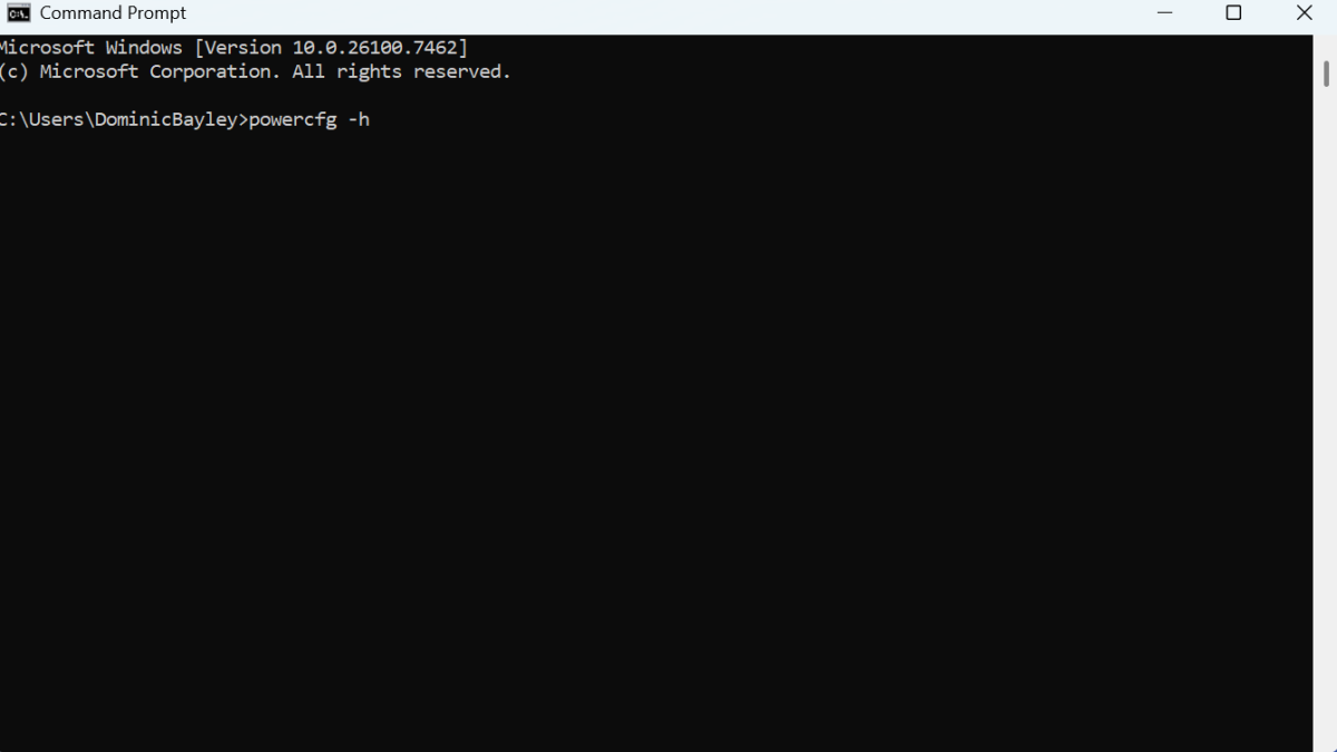

, SSDs, too, can encounter problems and run slower than expected. If you have a sluggish SSD, don’t fret. Here are my five essential tips to help you speed it up.1. Free up space
When your SSD’s space is filled up it will run a lot slower. If your SSD is at 90 percent capacity and you start to notice some performance issues, your first step should be to delete unnecessary files and folders. Another thing you can do is to disable hibernation as this could free up some disk space. Here’s how to do that:
- Type CMD in Windows search.
- Right-click on the top search result and choose Run as Administrator.
- Type powercfg -h and hit Enter.
- Once you’ve followed the steps above to clear some space in your SSD, check if there has been any improvement in the read/write speed. If it didn’t work, try the next solution.
