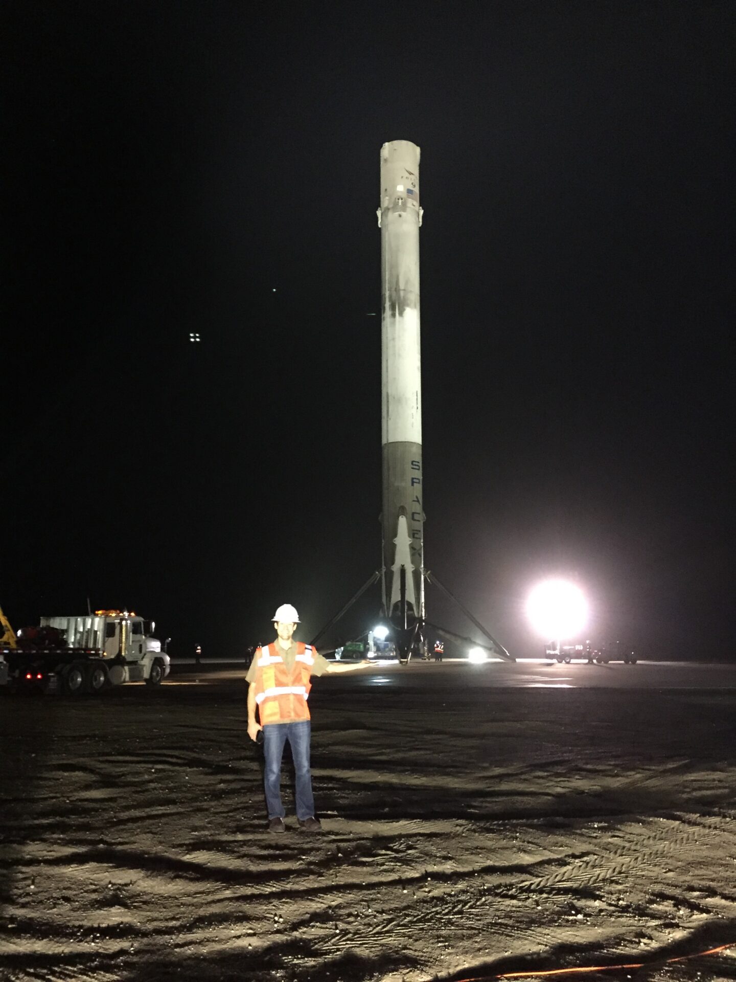

Catriona Chambers came to SpaceX in early 2005 as an electronics engineer. Within months on the job, she picked up responsibility for the Merlin engine computer on the Falcon 1 rocket. On that small rocket’s very first launch, there was a sensor that measured atmospheric pressure. After reaching space, the first stage would descend back to Earth, and when the sensor detected a thickening atmosphere, it would command deployment of a parachute. She and everyone who worked on the rocket knew this was preposterous. The rocket would probably never survive, and the parachute would be practically useless. But Musk pushed hard for reuse from the very beginning of SpaceX. Now here she was, almost eleven years later, observing it actually happen. As director of avionics, she watched with her team as the first stage landed, feeling the weight of history as she hugged and high-fived her friends.
Robb Kulin stands in front of the first landed Falcon 9 rocket in December 2015. Credit: Hans Koenigsmann
“That was the point where it really sunk in that we had been working on this for so long,” Chambers said. “It just felt so massive, and I was so excited. And then I realized I needed to calm down.” She was eight months pregnant, after all.
