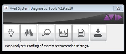

The first thing you should do is run the (ASDT) Avid System Diagnostic Tool's "BaseAnalyzer". You can download the ASDT below.
Avid System Diagnostic Tools are updated regularly and Avid recommends that the latest version is used wherever possible. The latest version is available from the following link:
Avid Collect Suite for Windows
Some users may experience difficulty opening this FTP link in a Web Browser. The following connection details can be used with a standard FTP client to download the latest ASDT installer file:
FTP site: ftp://interplay.avid.com
User: guest
Password: [none required]
If you have installed a previous ASDT version use the builtin update function to update and get the latest available version.
Once you have installed the ASDT.

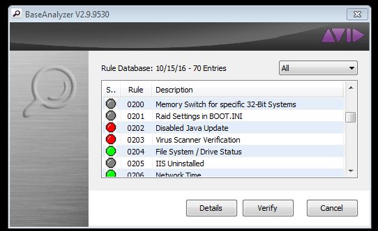

Find the BaseAnalyzer magnify glass icon. This will run a verify process and help optimize the client.

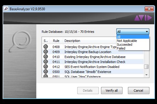

Click Verify All.
Once the BaseAnalyzer is complete, select the failed items and click details on them as you go down the list.
If you see a fix button when clicking on the failed items, press this "fix" button to resolve the issue. Sometimes to fix an issue, you must perform a manual operation, you can find these steps in the details button on each failed item.
